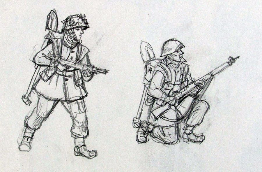

Having decided on the design, perhaps with a sketch..

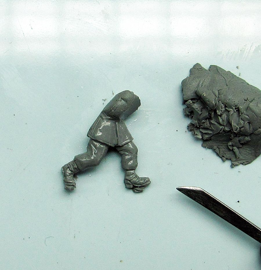

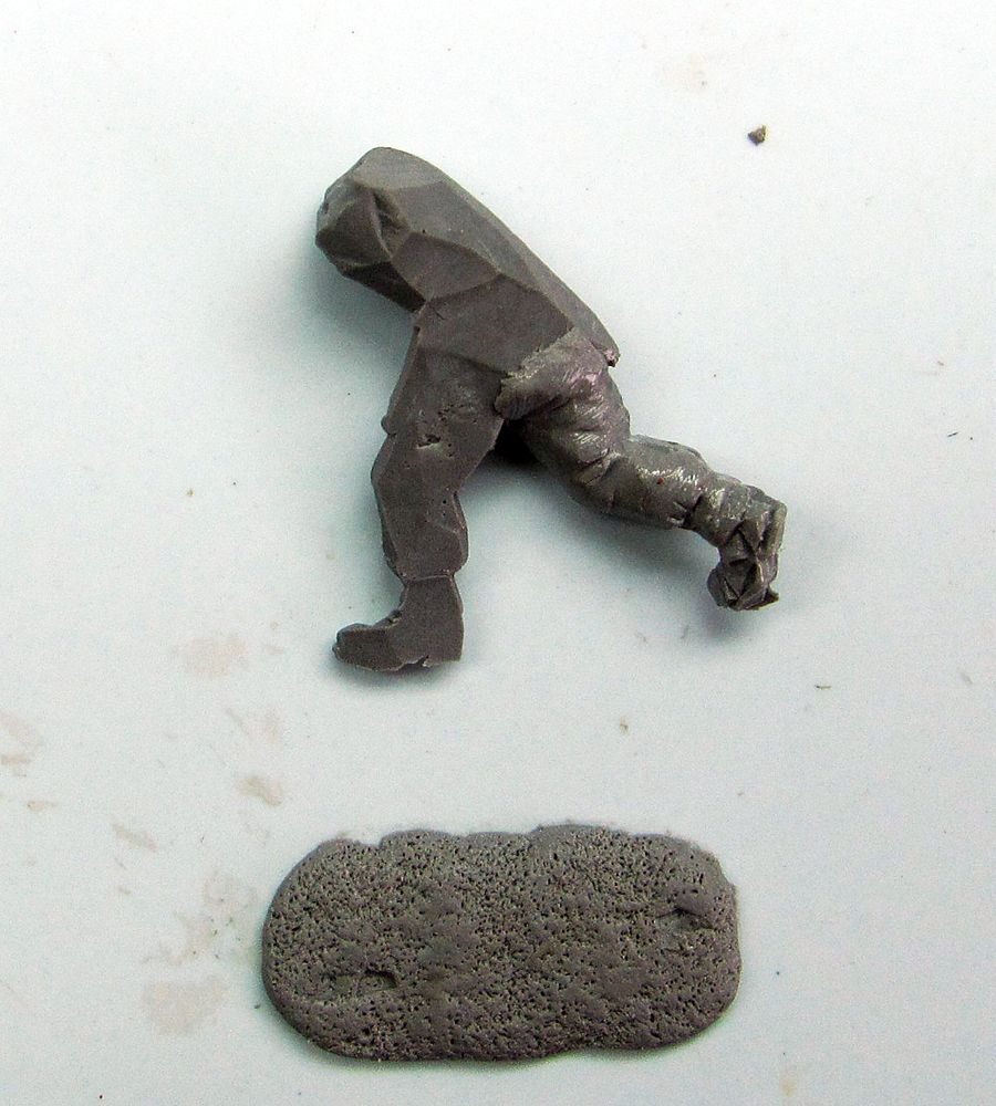

..Place blob of Fimo on tile and set to work. The tile acts as the armature, so no silly bits of wire are needed. I generally make the legs and torso in the first session..

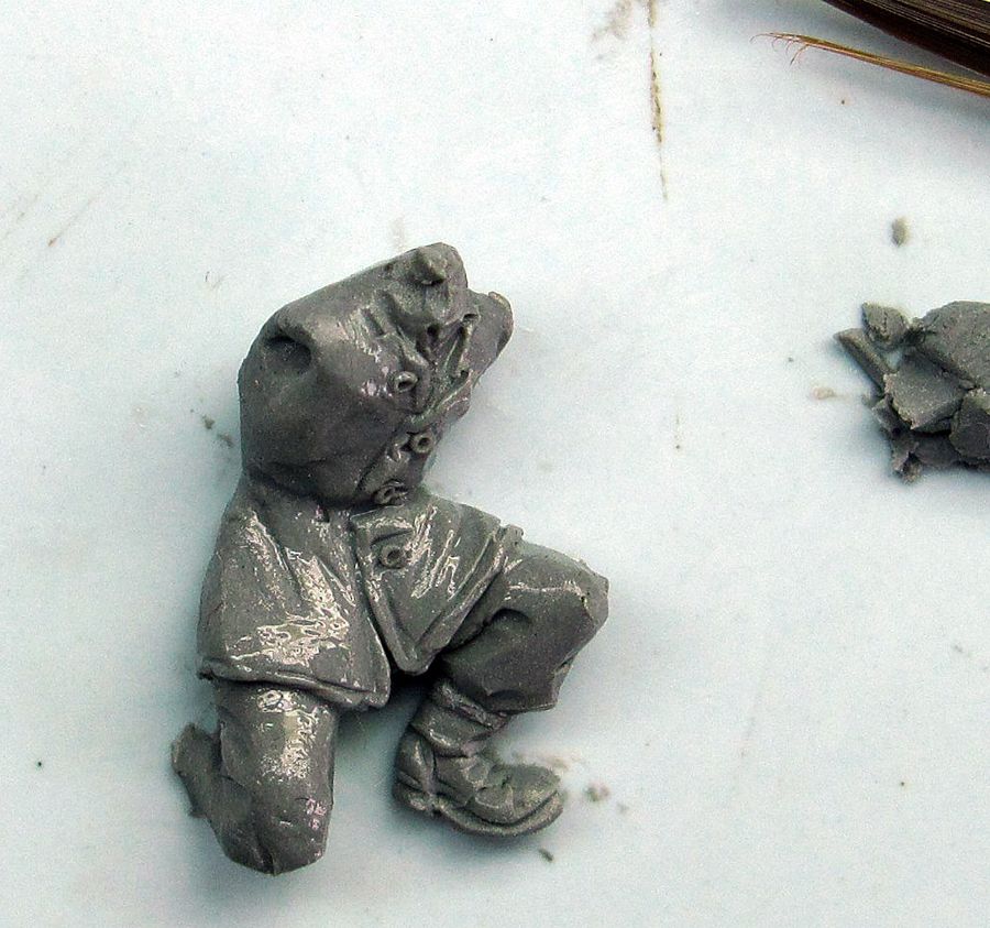

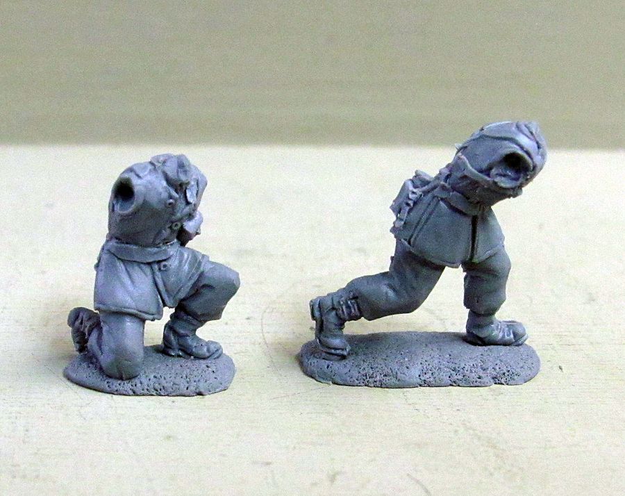

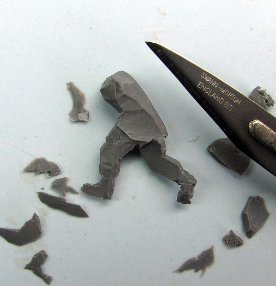

Then fire in the electric oven at 125C. Once fired, pop off the tile , carve off any unwanted edges , and start adding the other side of the legs.
Fire again, this time on a base.
The other figure, this time kneeling.

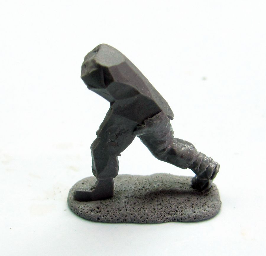

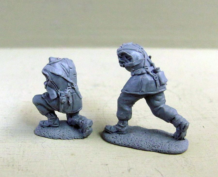

We now have two torsos on bases, with legs almost complete...

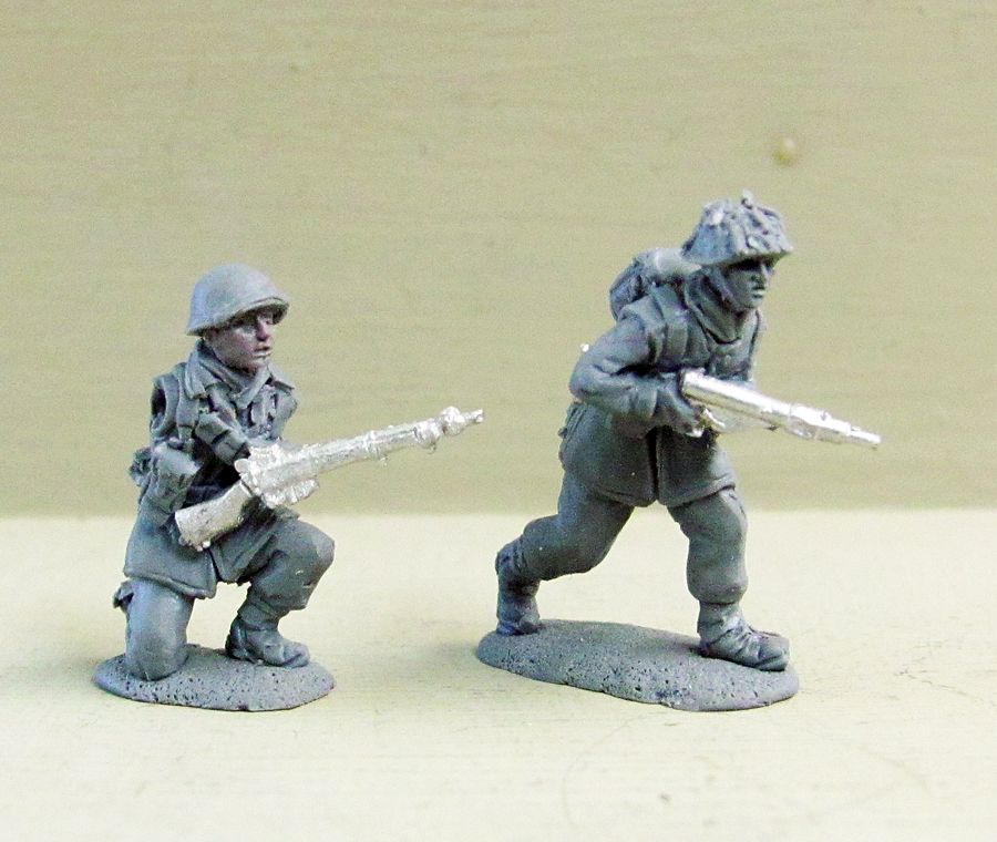

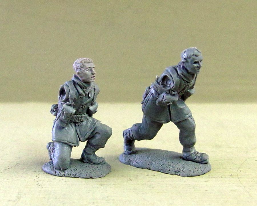

Heads I make separately, and then add to the torso, followed by the first of the equipment detail, and so on.
You can fire the figure many, many times, so long as the temperature never exceeds the correct 125C.

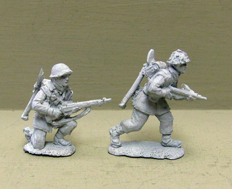

Add weapons which have been previously cast in tin to ensure uniformity...

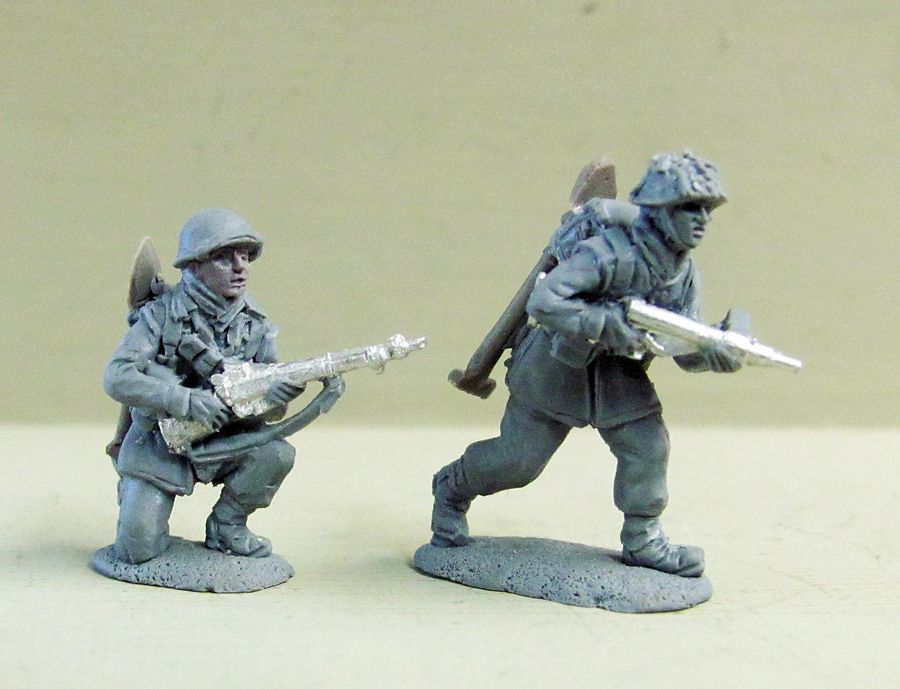

And after several more sessions, you have two complete master figures...

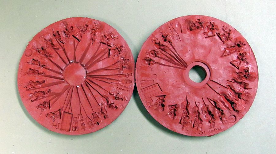

CASTING:~
The Fimo figure has to be copied into metal to make the production mould.
I use a Centricast system from Tiranti, which is basically a circular mould box and all its fittings, and a small centrifuge onto which the mouldbox fits, used both to create the mould by pouring rubber into the mouldbox ,and after to fill the cured mould with molten metal. The rubber is RTV, in other words it sets at room temperature, which can be mixed and poured in a plastic jug.The red rubber is designed for casting metal .

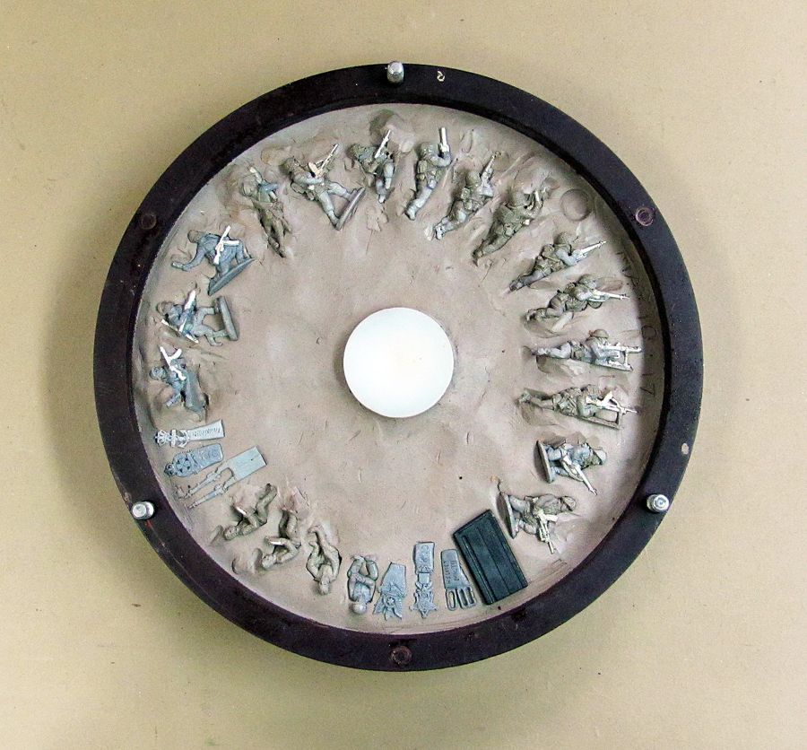

Start by filling the box with clay, to make a bed to lay the figures in..
Carefully embed the figures, cunningly sculpting the part line to make extraction of the casting easy. Once the circumference is filled, prepare the rubber and pour it in...
Close the mouldbox and top it up. Rubber sets in about ten hours.
A day later, open the box, remove clay, clean rubber surface all around figures ( several hours work) and pour second half....

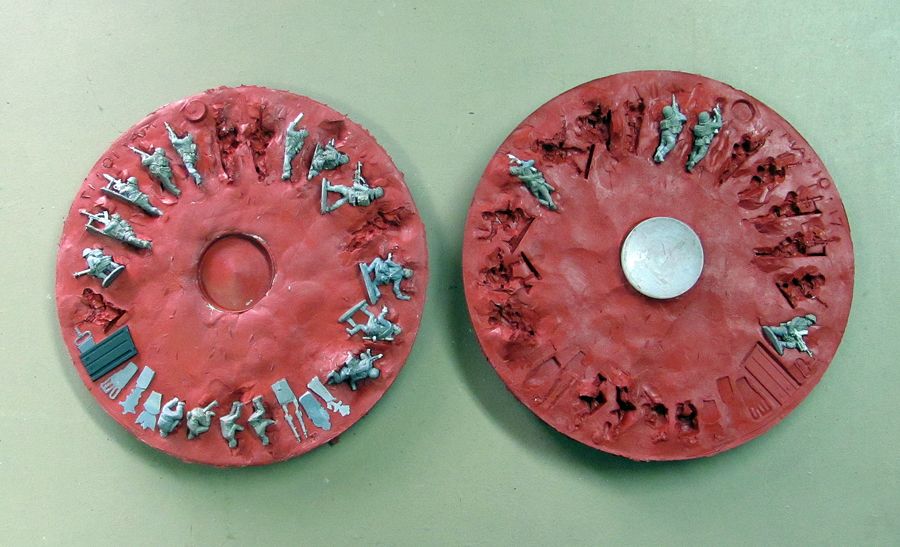

Then open the mould carefully :
Remove the Fimo masters,cut entry flues for metal :
The red rubber mould then goes back into the mouldbox , is put on the centrifuge rotor,set spinning, then has molten metal poured into the centre hole.
All being well, and with a few adjustments to the flues, after about an hour’s work casting I have a full set of figures. There are occasional mould tears which can ruin a casting, but mostly it works well.

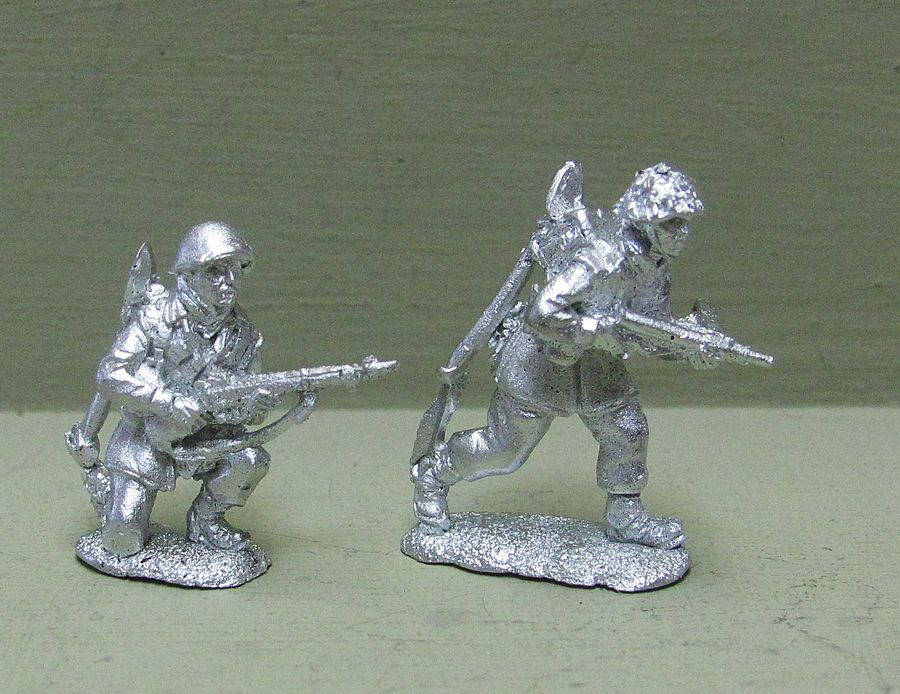

Metal castings:
After any fettling , these are sent in sets to the factory to be squeezed between two slabs of black rubber in a vulcanising press, to creat the very tough production mould.
The figures cast from that are what you buy. They are very fractionally slimmer than the metal masters, but that is taken account of when sculpting

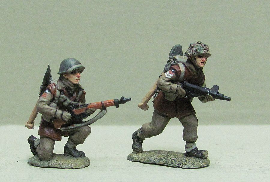

I keep a few as spares, and paint them for display and catalog photos...

Remember you can heat a piece, add a bit, heat it, add some more, heat it , and so on more or less for ever. Half heating it is not a good idea except in an emergency.
